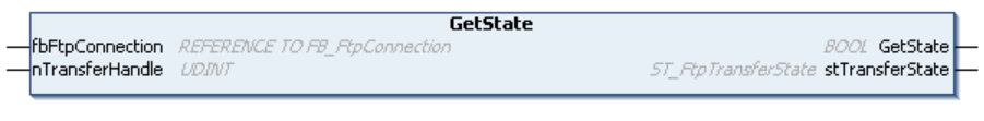

GetState
GetState 1:
Returns the current state of a specific transfer operation. This method can be used, for example, to check the progress of a file upload/download.
Syntax
METHOD GetState : BOOL
    fbFtpConnection : REFERENCE TO FB_FtpConnection;
    nTransferHandle : UDINT;
    stTransferState : ST_FtpTransferState;
GetState 2: Return value
Type
GetState
Returns TRUE when the method has completed. Whether the action was successful can be read from the bError variable of the function block.
stTransferState
ST_FtpTransferState
Contains the state information for the transfer operation.
GetState 3: Inputs
Type
fbFtpConnection
FB_FtpConnection
References the server connection to be used for the operation.
nTransferHandle
UDINT
TransferHandle of the transfer operation.
