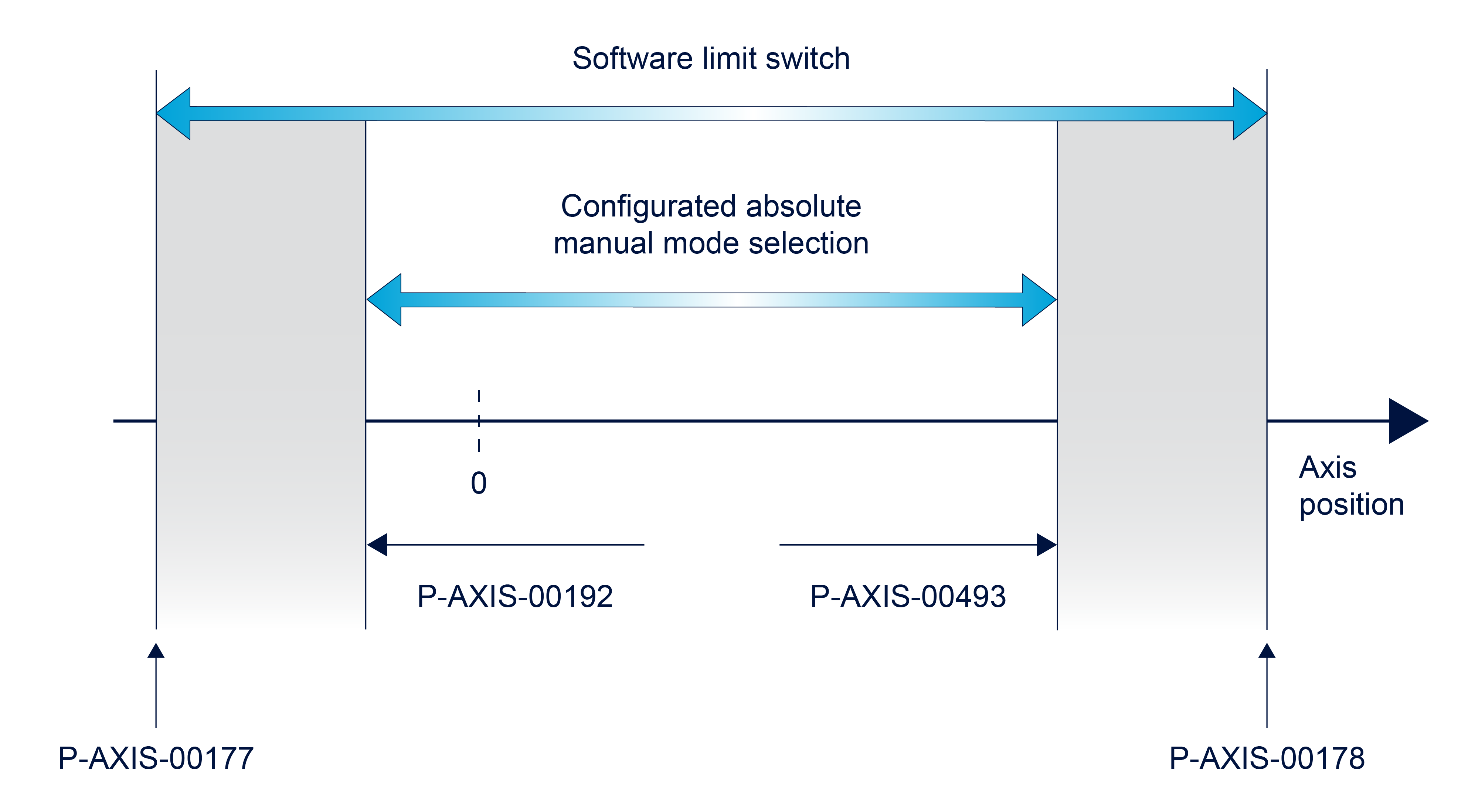

ACS movement limits
These parameters delimit the axis-specific motion range in manual mode at the axis coordinate level. In contrast to the offset limits P-AXIS-00137 and P-AXIS-00138, these values are always absolute values which affect the level of the axis coordinates. The adjustable minimum and maximum values are determined by the software limit switches.
ACS movement limits 1:
Absolute motion limits in manual mode.
