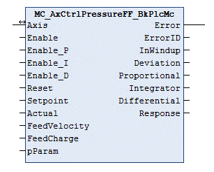

MC_AxCtrlPressureFF_BkPlcMc
The function block regulates the pressure acting on an axis in such a way that the desired default value SetPoint is set up and maintained in Actual. Alternatively, forces can also be used as actual values and setpoints.
In most cases the actual pressure can be logged with function blocks of type MC_AxRtReadPressureSingle_BkPlcMc or MC_AxRtReadPressureDiff_BkPlcMc. Function blocks of type MC_AxRtReadForceSingle_BkPlcMc or MC_AxRtReadForceDiff_BkPlcMc are suitable for an actual force.
Inputs
Enable: BOOL:=FALSE;
Enable_P: BOOL:=TRUE;
Enable_I: BOOL:=TRUE;
Enable_D: BOOL:=TRUE;
Reset: BOOL:=TRUE;
Setpoint: LREAL:=0.0;
Actual: LREAL:=0.0;
FeedVelocity: LREAL:=0.0;
FeedCharge: LREAL:=0.0;
pParam: POINTER TO ST_TcPctrlParam;
Name | Type | Description |
Enable | BOOL | TRUE at this input activates the controller. |
Enable_P | BOOL | A TRUE at this input activates the proportional component of the controller. |
Enable_I | BOOL | A TRUE at this input activates the integrator of the controller if the proportional component is active. |
Enable_D | BOOL | A TRUE at this input activates the differential component of the controller if the proportional component is active. |
Reset | BOOL | TRUE at this input resets the controller. The memory of the I part is cleared. |
Setpoint | LREAL | The setpoint of the controller. |
Actual | LREAL | The actual value of the controller. |
FeedVelocity | LREAL | The default value for a lower-level pre-control. |
FeedCharge | LREAL | An instantaneously effective and permanent change in the integral component. |
pParam | POINTER TO ST_TcPctrlParam | The address of a structure with the controller parameters. If zero is transferred here, the controller uses the parameters in stAxParams.stPctrl. |
Inputs/outputs
VAR_INOUT
Axis: Axis_Ref_BkPlcMc;
Axis | Axis_Ref_BkPlcMc | Here, the address of a variable of type Axis_Ref_BkPlcMc (from V3.0) should be transferred. |
Outputs
Error: BOOL;
ErrorID: UDINT;
InWindup: UDINT;
Deviation: LREAL;
Proportional: LREAL;
Integrator: LREAL;
Differential: LREAL;
Response: LREAL;
Error | BOOL | A TRUE here signals an error. |
ErrorID | UDINT | A numerically encoded error indication. |
InWindup | UDINT | A TRUE here signals that the integrator is limited by the WindupLimit. |
Deviation | LREAL | The current controller deviation. |
Proportional | LREAL | The current proportional component. |
Integrator | LREAL | The current integral component. |
Differential | LREAL | The current differential component. |
Response | LREAL | The output of the controller. |

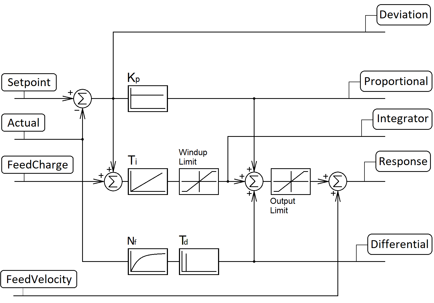

The controller has a complete PID core, the individual components of which can be switched on and off via Boolean inputs regardless of their parameters.
In addition, a pre-control input is available, which makes it easier to adapt the control against a moving object to the velocity of the object. If necessary, the component of the integrator can be instantaneously changed with the input FeedCharge.
