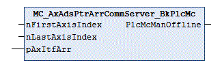

MC_AxAdsPtrArrCommServer_BkPlcMc
The function block gives the application the capacity to function as an ADS server. Calls function blocks of type MC_AxAdsReadDecoder_BkPlcMc and MC_AxAdsWriteDecoder_BkPlcMc as required. The ADS codes are listed in the Knowledge Base.
![]() | For most applications an MC_AxAdsCommServer_BkPlcMc is adequate and preferable. |
Inputs
nFirstAxisIndex: INT;
nLastAxisIndex: INT;
Name | Type | Description |
nFirstAxisIndex | INT | This parameter is used to specify the dimensioning of the Axis_Ref_BkPlcMc array. An incorrect specification at this point excludes some of the axes from the communication or results in a crash of the PLC application by triggering serious runtime errors (Page Fault Exception). |
nLastAxisIndex | INT |
Inputs/outputs
VAR_INOUT
pAxItfArr: POINTER TO DWORD;
pAxItfArr | POINTER | Here, the address of a variable of type ARRAY [ncnstFirstAxId..ncnstLastAxId] OF POINTER TO Axis_Ref_BkPlcMc should be transferred. An incorrect specification at this point causes the PLC application to crash inevitably through triggering of serious runtime errors (Page Fault Exception). |
Outputs
PlcMcManOffline: BOOL;
PlcMcManOffline | BOOL | This parameter corresponds to the parameter of the same name of the MC_AxAdsCommServer_BkPlcMc function block. |
Through cyclic calling of this function block in the PLC application, the application assumes the character of an ADS server and responds to ADS read and ADS write-access like any other ADS server. This includes the decoding of IdxGroup/IdxOffset addressing. Function blocks of type MC_AxAdsReadDecoder_BkPlcMc and MC_AxAdsWriteDecoder_BkPlcMc are called as required.
![]() | This function block must not be used if the PLC application already is an ADS server. |
In this case the function blocks of type MC_AxAdsReadDecoder_BkPlcMc and MC_AxAdsWriteDecoder_BkPlcMc should be called from the existing ADS server function block of the application.
A program example #16 is available.
