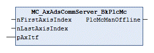

MC_AxAdsCommServer_BkPlcMc (from V3.0)
The function block gives the application the capacity to function as an ADS server. Calls function blocks of type MC_AxAdsReadDecoder_BkPlcMc and MC_AxAdsWriteDecoder_BkPlcMc as required. The ADS codes are listed in the Knowledge Base.

Through cyclic calling of this function block in the PLC application, the application assumes the character of an ADS server and responds to ADS read and ADS write-access like any other ADS server. This includes the decoding of IdxGroup/IdxOffset addressing. Function blocks of type MC_AxAdsReadDecoder_BkPlcMc and MC_AxAdsWriteDecoder_BkPlcMc are called as required.
![]() | This function block must not be used if the PLC application already is an ADS server. |
In this case the function blocks of type MC_AxAdsReadDecoder_BkPlcMc and MC_AxAdsWriteDecoder_BkPlcMc should be called from the existing ADS server function block of the application.
