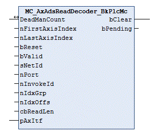

MC_AxAdsReadDecoder_BkPlcMc (from V3.0)
The function block decodes ADS read accesses. The ADS codes are listed in the Knowledge Base.
Inputs
nFirstAxisIndex: INT;
nLastAxisIndex: INT;
bReset: BOOL;
bValid: BOOL;
sNetId: STRING(80);
nPort: UINT;
nInvokeId: UDINT;
nIdxGroup: UDINT;
nIdxOffs: UDINT;
cbReadLen: UDINT;
pAxItf: POINTER TO Axis_Ref_BkPlcMc:=0;
