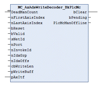

MC_AxAdsWriteDecoder_BkPlcMc (from V3.0)
The function block decodes ADS write accesses. The ADS codes are listed in the Knowledge Base.

Name | Type | Description |
nFirstAxisIndex | INT | This parameter is used to specify the dimensioning of the Axis_Ref_BkPlcMc array. An incorrect specification at this point excludes some of the axes from the communication or results in a crash of the PLC application by triggering serious runtime errors (Page Fault Exception). |
nLastAxisIndex | INT | |
bReset | BOOL | The signals are used to co-ordinate the decoder with the ADS server. |
bValid | BOOL | |
sNetId | STRING | These values are required in order to generate the ADS response. They are supplied by an ADS server's ADS indication function block. |
nPort | UINT | |
nInvokeId | UDINT | |
nIdxGroup | UDINT | These values are required in order to decode the access. They are supplied by an ADS server's ADS indication function block. |
nIdxOffs | UDINT | |
cbWriteLen | UDINT | |
pWriteBuff | DWORD |
pAxItf | POINTER | Here, the address of a variable or an array of variables of type Axis_Ref_BkPlcMc should be transferred. |
DeadManCount | UDINT |
bClear | BOOL | Indicates that an ADS access indicated with bValid should be acknowledged. |
bPending | BOOL | Indicates that an ADS access indicated with bValid is being processed. |
PlcMcManOffline | BOOL |
If, when the bValid signal is present, the function block indicates neither bClear nor bPending it has not decoded the combination of nIdxGroup and nIdxOffs, and has not generated a response. In such a case, the ADS server (if there is one) must call another decoder, or must generate a response with the appropriate error code.
