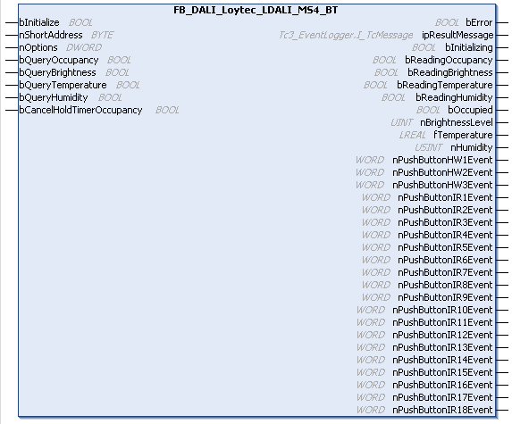

FB_DALI_Loytec_LDALI_MS4_BT 2:
Set the times so that as few events as possible are sent. If too many events are sent, this can have a negative effect on the behavior of the application.
FB_DALI_Loytec_LDALI_MS4_BT 3:
FB_DALI_Loytec_LDALI_MS4_BT 4: Inputs

FB_DALI_Loytec_LDALI_MS4_BT 5: Outputs
  bError               : BOOL;
