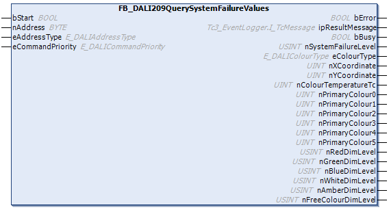

FB_DALI209QuerySystemFailureValues 1:
The function block reads the variable systemFailureLevel and the corresponding color/color temperature settings from the DALI control gear.
FB_DALI209QuerySystemFailureValues 2:
In addition to the DALI command QUERY SYSTEM FAILURE LEVEL, the function block sends the DALI commands QUERY COLOUR VALUE and ENABLE DEVICE TYPE 8, as is necessary for application extended commands (see FB_DALI102EnableDeviceType).
FB_DALI209QuerySystemFailureValues 3:
The function block changes the DTR0 of all connected DALI control gears.
The outputs only contain valid values if the function block was executed without errors (bError = FALSE).
FB_DALI209QuerySystemFailureValues 4: Inputs
  bStart            : BOOL;
  nAddress          : BYTE;
Type
bStart
nAddress
BYTE
eAddressType
E_DALIAddressType
eCommandPriority
E_DALICommandPriority
FB_DALI209QuerySystemFailureValues 5:
FB_DALI209QuerySystemFailureValues 6: Outputs
  nSystemFailureLevel     : USINT;
  eColourType             : E_DALIColourType;
  nXCoordinate            : UINT;
  nYCoordinate            : UINT;
  nColourTemperatureTc    : UINT;
  nPrimaryColour0         : UINT;
  nPrimaryColour1         : UINT;
  nPrimaryColour2         : UINT;
  nPrimaryColour3         : UINT;
  nPrimaryColour4         : UINT;
  nPrimaryColour5         : UINT;
  nRedDimLevel            : USINT;
  nGreenDimLevel          : USINT;
  nBlueDimLevel           : USINT;
  nWhiteDimLevel          : USINT;
  nAmberDimLevel          : USINT;
  nFreeColourDimLevel     : USINT;
