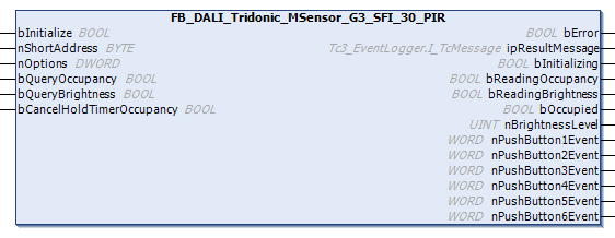

FB_DALI_Tridonic_MSensorG3_SFI_30_PIR 4: Inputs
  bInitialize                 : BOOL  := FALSE;
  nShortAddress               : BYTE  := 0;
  nOptions                    : DWORD := 0;
  bQueryOccupancy             : BOOL  := FALSE;
  bQueryBrightness            : BOOL  := FALSE;
  bCancelHoldTimerOccupancy   : BOOL  := FALSE;
Type
bInitialize
The configuration of the DALI control device is started by a positive edge at this input. During this time no DALI commands are processed.
nShortAddress
BYTE
Short address (0…63) of the DALI control device.
nOptions
DWORD
Reserved for future extensions.
bQueryOccupancy
The occupancy is queried immediately by a positive edge at this input.
bQueryBrightness
The brightness is queried immediately by a positive edge at this input.
A positive edge at this input prematurely ends the Hold Timer and resets the output bOccupied.
FB_DALI_Tridonic_MSensorG3_SFI_30_PIR 5: Outputs
  bError                 : BOOL;
  ipResultMessage        : I_TcMessage;
  bInitializing          : BOOL;
  bReadingOccupancy      : BOOL;
  bReadingBrightness     : BOOL;
  bOccupied              : BOOL;
  nBrightnessLevel       : UINT;
  nPushButton1Event      : WORD;
  nPushButton2Event      : WORD;
  nPushButton3Event      : WORD;
  nPushButton4Event      : WORD;
  nPushButton5Event      : WORD;
  nPushButton6Event      : WORD;
