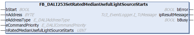

FB_DALI253SetRatedMedianUsefulLightSourceStarts
FB_DALI253SetRatedMedianUsefulLightSourceStarts 1:
The function block writes the average number of possible starts of the complete luminaire to the DALI control gear.
The function block FB_DALI253QueryRatedMedianUsefulLightSourceStarts reads the value from the DALI control gear.
FB_DALI253SetRatedMedianUsefulLightSourceStarts 2: Inputs
  bStart                               : BOOL;
  nAddress                             : BYTE;
  eAddressType                         : E_DALIAddressType := E_DALIAddressType.Short;
  eCommandPriority                     : E_DALICommandPriority := E_DALICommandPriority.MiddleLow;
  nRatedMedianUsefulLightSourceStarts  : UINT;
Type
bStart
nAddress
BYTE
eAddressType
E_DALIAddressType
eCommandPriority
FB_DALI253SetRatedMedianUsefulLightSourceStarts 3:
Type
UINT
Number of average possible starts. The input value is between 0 and 65533, as a multiple of the step size of 100.
FB_DALI253SetRatedMedianUsefulLightSourceStarts 4: Outputs
Type
ipResultMessage
I_TcMessage
bBusy
FB_DALI253SetRatedMedianUsefulLightSourceStarts 5: Properties
Type
Access
Initial value
ipDALICommunication
I_DALICommunication
Get, Set
NULL
Requirements
Development environment
Required PLC library
TwinCAT from v3.1.4024.10
Tc3_DALI from v3.4.0.0
