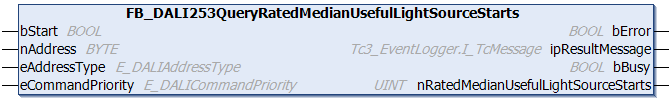

FB_DALI253QueryRatedMedianUsefulLightSourceStarts 1:
The function block indicates the average number of possible starts of the complete luminaire, including all individual components.
The function block FB_DALI253SetRatedMedianUsefulLightSourceStarts writes the value to the DALI control gear.
The output nRatedMedianUsefulLightSourceStarts contains a valid value only if the function block was executed without errors (bError = FALSE).
FB_DALI253QueryRatedMedianUsefulLightSourceStarts 2: Inputs
  bStart            : BOOL;
  nAddress          : BYTE;
Type
bStart
nAddress
BYTE
eAddressType
E_DALIAddressType
eCommandPriority
E_DALICommandPriority
FB_DALI253QueryRatedMedianUsefulLightSourceStarts 3:
FB_DALI253QueryRatedMedianUsefulLightSourceStarts 4: Outputs
  bError                                 : BOOL;
  ipResultMessage                        : I_TcMessage;
  bBusy                                  : BOOL;
  nRatedMedianUsefulLightSourceStarts    : UINT;
Type
ipResultMessage
I_TcMessage
bBusy
UINT
Number of average possible starts [100]. The value lies within the range 0...65533 as a multiple of the step size of 100.
