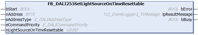

FB_DALI253SetLightSourceOnTimeResettable 1:
The function block sets the resettable operating hour counter of the light source to any desired value. If the light source is switched on, the resettable operating hour counter is incremented by one every second.
The resettable operating hour counter can be read using the function block FB_DALI253QueryLightSourceOnTimeResettable.
FB_DALI253SetLightSourceOnTimeResettable 2: Inputs
  bStart                       : BOOL;
  nAddress                     : BYTE;
  eAddressType                 : E_DALIAddressType := E_DALIAddressType.Short;
  eCommandPriority             : E_DALICommandPriority := E_DALICommandPriority.MiddleLow;
  nLightSourceOnTimeResettable : UDINT;

FB_DALI253SetLightSourceOnTimeResettable 3:
Type
UDINT
New value of the resettable operating hours counter [s] (0…4294967293)
FB_DALI253SetLightSourceOnTimeResettable 4: Outputs
Type
ipResultMessage
I_TcMessage
bBusy
FB_DALI253SetLightSourceOnTimeResettable 5: Properties
Type
Access
Initial value
ipDALICommunication
I_DALICommunication
Get, Set
NULL
