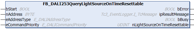

FB_DALI253QueryLightSourceOnTimeResettable
The function block reads the resettable operating hour counter of the light source. If the light source is switched on, the resettable operating hour counter is incremented by one every second. The resettable operating hours counter can be changed by the function block FB_DALI253SetLightSourceOnTimeResettable.
The output nLightSourceOnTimeResettable contains a valid value only if the function block was executed without errors (bError = FALSE).

bBusy | BOOL | The output is set as soon as execution of the DALI commands has commenced. It remains active until all DALI commands have been processed. |
nLightSourceOnTimeResettable | UDINT | Current value of the resettable operating hours counter of the light source [s] (0…4294967293) |
