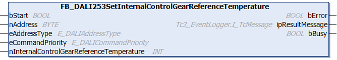

FB_DALI253SetInternalControlGearReferenceTemperature
FB_DALI253SetInternalControlGearReferenceTemperature 1:
The function block writes the internal reference temperature to the DALI control gear.
The function block FB_DALI253QueryInternalControlGearReferenceTemperature reads the value from the DALI control gear.
FB_DALI253SetInternalControlGearReferenceTemperature 2: Inputs
  bStart                                   : BOOL;
  nAddress                                 : BYTE;
  eAddressType                             : E_DALIAddressType := E_DALIAddressType.Short;
  eCommandPriority                         : E_DALICommandPriority := E_DALICommandPriority.MiddleLow;
  nInternalControlGearReferenceTemperature : INT;

FB_DALI253SetInternalControlGearReferenceTemperature 3:
Type
INT
Internal reference temperature [°C] (-60...193)
FB_DALI253SetInternalControlGearReferenceTemperature 4: Outputs
Type
ipResultMessage
I_TcMessage
bBusy
