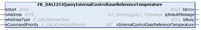

FB_DALI253QueryInternalControlGearReferenceTemperature
FB_DALI253QueryInternalControlGearReferenceTemperature 1:
The function block outputs the internal reference temperature of the DALI control gear.
The output nInternalControlGearReferenceTemperature only contains a valid value if the function block was executed without errors (bError = FALSE).
FB_DALI253QueryInternalControlGearReferenceTemperature 2: Inputs
  bStart            : BOOL;
  nAddress          : BYTE;
Type
bStart
nAddress
BYTE
eAddressType
E_DALIAddressType
eCommandPriority
E_DALICommandPriority
FB_DALI253QueryInternalControlGearReferenceTemperature 3:
FB_DALI253QueryInternalControlGearReferenceTemperature 4: Outputs
  bError                                  : BOOL;
  ipResultMessage                         : I_TcMessage;
  bBusy                                   : BOOL;
  nInternalControlGearReferenceTemperature: INT;
Type
ipResultMessage
I_TcMessage
bBusy
INT
Internal reference temperature [°C] (-60...193)
FB_DALI253QueryInternalControlGearReferenceTemperature 5: Properties
Type
Access
Initial value
ipDALICommunication
I_DALICommunication
Get,Set
0
Requirements
Development environment
Required PLC library
TwinCAT from v3.1.4024.10
Tc3_DALI from v3.4.0.0
