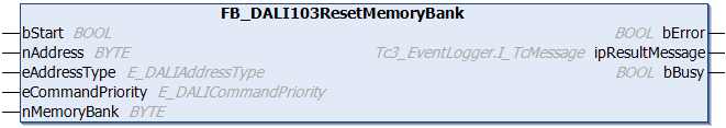

FB_DALI103ResetMemoryBank
FB_DALI103ResetMemoryBank 1:
The values of the selected memory bank of the DALI control device are set to their respective default values by the function block (see Memory banks).
During the reset, the DALI control device does not react to other commands.
The function block also resets the values that are write-protected by the lock byte.
The DALI commands ENABLE WRITE MEMORY, WRITE MEMORY LOCATION – NO REPLY and RESET MEMORY BANK are called internally.
FB_DALI103ResetMemoryBank 2:
The function block changes the DTR0 and the DTR1 of all connected DALI control devices.
FB_DALI103ResetMemoryBank 3:
The function block sends the DALI command RESET MEMORY BANK twice, as foreseen by the DALI standard for certain DALI commands.

FB_DALI103ResetMemoryBank 5: Inputs
  bStart            : BOOL;
  nAddress          : BYTE;
  nMemoryBank       : USINT := 2;
Type
bStart
nAddress
BYTE
Address of a DALI control device or a DALI group.
eAddressType
E_DALIAddressType
eCommandPriority
E_DALICommandPriority
FB_DALI103ResetMemoryBank 6:
The command priorities are supported by the KL6821 from the firmware version BD.
Type
nMemoryBank
USINT
Specification of the memory bank. If a 0 is specified, all memory banks are reset (except for memory bank 0, as this is read-only). For all other values, only the respective memory bank is reset.
FB_DALI103ResetMemoryBank 7: Outputs
Type
ipResultMessage
I_TcMessage
bBusy
FB_DALI103ResetMemoryBank 8: Properties
Type
Access
Initial value
ipDALICommunication
I_DALICommunication
Get, Set
NULL
Requirements
Development environment
Required PLC library
TwinCAT from v3.1.4024.10
Tc3_DALI from v3.4.0.0
