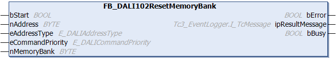

FB_DALI102ResetMemoryBank 1:
The values of the selected memory bank of the DALI control gear are set to their respective default values by the function block (see Memory banks).
During the reset, the DALI control gear does not react to other commands.
The function block also resets the values that are write-protected by the lock byte.
The DALI commands ENABLE WRITE MEMORY, WRITE MEMORY LOCATION – NO REPLY and RESET MEMORY BANK are called internally.
FB_DALI102ResetMemoryBank 2:
The function block changes the DTR0 and the DTR1 of all connected DALI control gears.
FB_DALI102ResetMemoryBank 3:
The function block sends the DALI command RESET MEMORY BANK twice, as foreseen by the DALI standard for certain DALI commands.
FB_DALI102ResetMemoryBank 4: Inputs
  bStart            : BOOL;
  nAddress          : BYTE;
  nMemoryBank       : BYTE := 2;
Type
bStart
nAddress
BYTE
eAddressType
E_DALIAddressType
eCommandPriority
E_DALICommandPriority
FB_DALI102ResetMemoryBank 5:
Type
MemoryBank
BYTE
Specification of the memory bank. If a 0 is specified, all memory banks are reset (except for memory bank 0, as this is read-only). For all other values, only the respective memory bank is reset.
