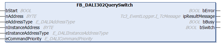

FB_DALI302QuerySwitch 1:
The function block queries whether the instance represents a switch.
The output bSwitch only contains a valid value if the function block was executed without errors (bError = FALSE).
FB_DALI302QuerySwitch 2:

FB_DALI302QuerySwitch 4:
