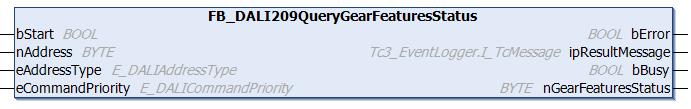

FB_DALI209QueryGearFeaturesStatus
FB_DALI209QueryGearFeaturesStatus 1:
The function block reads the variable gearFeatures/Status from the DALI control gear.
FB_DALI209QueryGearFeaturesStatus 2:
Prior to the DALI command QUERY GEAR FEATURES/STATUS, the function block sends the DALI command ENABLE DEVICE TYPE 8, as is necessary for application extended commands (see also FB_DALI102EnableDeviceType).
The output nGearFeaturesStatus only contains a valid value if the function block was executed without errors (bError = FALSE).
FB_DALI209QueryGearFeaturesStatus 3: Inputs
  bStart            : BOOL;
  nAddress          : BYTE;
Type
bStart
nAddress
BYTE
eAddressType
E_DALIAddressType
eCommandPriority
E_DALICommandPriority
FB_DALI209QueryGearFeaturesStatus 4:
FB_DALI209QueryGearFeaturesStatus 5: Outputs
  nGearFeatureStatus      : BYTE;
Type
ipResultMessage
I_TcMessage
bBusy
nGearFeatureStatus
BYTE
Output of the status information (see gearFeatures/Status).
FB_DALI209QueryGearFeaturesStatus 6: Properties
Type
Access
Initial value
ipDALICommunication
I_DALICommunication
Get, Set
NULL
Requirements
Development environment
Required PLC library
TwinCAT from v3.1.4024.10
Tc3_DALI from v3.4.0.0
