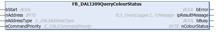

The function block reads the variable colourStatus from the DALI control gear.
![]() | Prior to the DALI command QUERY COLOUR STATUS, the function block sends the DALI command ENABLE DEVICE TYPE 8, as is necessary for application extended commands (see also FB_DALI102EnableDeviceType). |
The output nColourStatus contains a valid value only if the function block was executed without errors (bError = FALSE).
Inputs
bStart : BOOL;
nAddress : BYTE;
Outputs
bError : BOOL;
bBusy : BOOL;
nColourStatus : BYTE;
bBusy | BOOL | The output is set as soon as execution of the DALI commands has commenced. It remains active until all DALI commands have been processed. For some errors (e.g. faulty parameters), bError is set immediately after the positive edge at bStart without bBusy switching to TRUE. |
nColourStatus | BYTE | Output of the status information (see colourStatus). |
