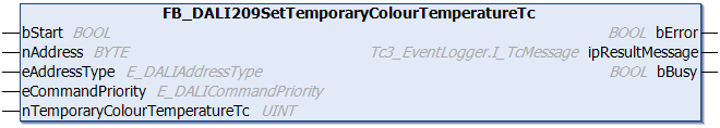

FB_DALI209SetTemporaryColourTemperatureTc
FB_DALI209SetTemporaryColourTemperatureTc 1:
The function block saves the value nTemporaryColourTemperatureTc in the variable temporaryTemperatureTc of the DALI control gear.
The value can be read with function block FB_DALI209QueryColourValue.
The value is expressed in units of 1 Mirek. A value of 0 is ignored and therefore not saved. The color temperature Tc can vary from 1 Mirek (1000000 K) to 65534 Mirek (15.26 K).
The functions KELVIN_TO_MIREK and MIREK_TO_KELVIN are available for converting from or to Kelvin.
FB_DALI209SetTemporaryColourTemperatureTc 2:
Prior to the DALI command SET TEMPORARY COLOUR TEMPERATURE Tc, the function block sends the DALI command ENABLE DEVICE TYPE 8, as is necessary for application extended commands (see also FB_DALI102EnableDeviceType).
FB_DALI209SetTemporaryColourTemperatureTc 3:
The function block changes the DTR0 and the DTR1 of all connected DALI control gears.
FB_DALI209SetTemporaryColourTemperatureTc 4: Inputs
  bStart                         : BOOL;
  nAddress                       : BYTE;
  eAddressType                   : E_DALIAddressType := E_DALIAddressType.Short;
  eCommandPriority               : E_DALICommandPriority := E_DALICommandPriority.MiddleLow;
  nTemporaryColourTemperatureTc  : UINT;
