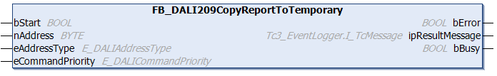

FB_DALI209CopyReportToTemporary
FB_DALI209CopyReportToTemporary 1:
The function block copies the contents of the variables with the color settings to the variables for the temporary color settings.
FB_DALI209CopyReportToTemporary 2:
Prior to the DALI command COPY REPORT TO TEMPORARY, the function block sends the DALI command ENABLE DEVICE TYPE 8, as is necessary for application-related extension commands (see also FB_DALI102EnableDeviceType).
FB_DALI209CopyReportToTemporary 3: Inputs
  bStart            : BOOL;
  nAddress          : BYTE;
Type
bStart
nAddress
BYTE
eAddressType
E_DALIAddressType
eCommandPriority
E_DALICommandPriority
FB_DALI209CopyReportToTemporary 4:
FB_DALI209CopyReportToTemporary 5: Outputs
Type
ipResultMessage
I_TcMessage
bBusy
FB_DALI209CopyReportToTemporary 6: Properties
Type
Access
Initial value
ipDALICommunication
I_DALICommunication
Get, Set
NULL
Requirements
Development environment
Required PLC library
TwinCAT from v3.1.4024.10
Tc3_DALI from v3.4.0.0
