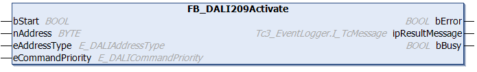

FB_DALI209Activate 1:
The function block causes the buffered values of the temporary registers to be transferred to the lamp.
It ends a running cross-fade and starts a new cross-fade for the respective color/color temperature.
FB_DALI209Activate 2:
Prior to the DALI command ACTIVATE, the function block sends the DALI command ENABLE DEVICE TYPE 8, as is necessary for application extended commands (see also FB_DALI102EnableDeviceType).
FB_DALI209Activate 3: Inputs
  bStart            : BOOL;
  nAddress          : BYTE;
Type
bStart
nAddress
BYTE
eAddressType
E_DALIAddressType
eCommandPriority
E_DALICommandPriority
FB_DALI209Activate 4:
FB_DALI209Activate 5: Outputs
Type
ipResultMessage
I_TcMessage
bBusy
FB_DALI209Activate 6: Properties
Type
Access
Initial value
ipDALICommunication
I_DALICommunication
Get, Set
NULL
