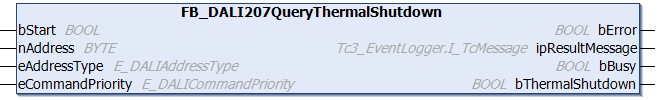

FB_DALI207QueryThermalShutdown
The function block queries whether a thermal shutdown has taken place.
![]() | Prior to the DALI command QUERY THERMAL SHUTDOWN, the function block sends the DALI command ENABLE DEVICE TYPE 6, as is necessary for application extended commands (see also FB_DALI102EnableDeviceType). |
The output bThermalShutdown contains a valid value only if the function block was executed without errors (bError = FALSE).
Inputs
bStart : BOOL;
nAddress : BYTE;
Outputs
bError : BOOL;
bBusy : BOOL;
bThermalShutdown : BOOL;
bBusy | BOOL | The output is set as soon as execution of the DALI commands has commenced. It remains active until all DALI commands have been processed. For some errors (e.g. faulty parameters), bError is set immediately after the positive edge at bStart without bBusy switching to TRUE. |
bThermalShutdown | BOOL | Indicates whether a thermal shutdown has taken place. |
