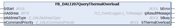

FB_DALI207QueryThermalOverload
The function block queries whether there is a thermal overload with reduction of the output level.
![]() | Prior to the DALI command QUERY THERMAL OVERLOAD, the function block sends the DALI command ENABLE DEVICE TYPE 6, as is necessary for application extended commands (see also FB_DALI102EnableDeviceType). |
The output bThermalOverload contains a valid value only if the function block was executed without errors (bError = FALSE).
Inputs
bStart : BOOL;
nAddress : BYTE;
Outputs
bError : BOOL;
bBusy : BOOL;
bThermalOverload : BOOL;
bBusy | BOOL | The output is set as soon as execution of the DALI commands has commenced. It remains active until all DALI commands have been processed. |
bThermalOverload | BOOL | Indicates whether thermal overload is present. |
