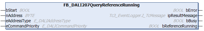

FB_DALI207QueryReferenceRunning
FB_DALI207QueryReferenceRunning 1:
The function block queries whether a reference measurement of the system power is activated.
FB_DALI207QueryReferenceRunning 2:
Prior to the DALI command QUERY REFERENCE RUNNING, the function block sends the DALI command ENABLE DEVICE TYPE 6, as is necessary for application extended commands (see also FB_DALI102EnableDeviceType).
The output bReferenceRunning contains a valid value only if the function block was executed without errors (bError = FALSE).
FB_DALI207QueryReferenceRunning 3: Inputs
  bStart            : BOOL;
  nAddress          : BYTE;
Type
bStart
nAddress
BYTE
eAddressType
E_DALIAddressType
eCommandPriority
E_DALICommandPriority
FB_DALI207QueryReferenceRunning 4:
FB_DALI207QueryReferenceRunning 5: Outputs
  bReferenceRunning       : BOOL;
Type
ipResultMessage
I_TcMessage
bBusy
bReferenceRunning
Indicates whether the reference measurement of the system performance is performed.
FB_DALI207QueryReferenceRunning 6: Properties
Type
Access
Initial value
ipDALICommunication
I_DALICommunication
Get, Set
NULL
