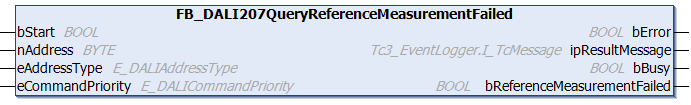

FB_DALI207QueryReferenceMeasurementFailed
The function block queries whether a started reference measurement has failed.
![]() | Prior to the DALI command QUERY REFERENCE MEASUREMENT FAILED, the function block sends the DALI command ENABLE DEVICE TYPE 6, as is necessary for application extended commands (see also FB_DALI102EnableDeviceType). |
The output bReferenceMeasurementFailed contains a valid value only if the function block was executed without errors (bError = FALSE).
Inputs
bStart : BOOL;
nAddress : BYTE;
Outputs
bError : BOOL;
bBusy : BOOL;
bReferenceMeasurementFailed : BOOL;
bBusy | BOOL | The output is set as soon as execution of the DALI commands has commenced. It remains active until all DALI commands have been processed. For some errors (e.g. faulty parameters), bError is set immediately after the positive edge at bStart without bBusy switching to TRUE. |
bReferenceMeasurementFailed | BOOL | Indicates whether the reference measurement failed. |
Properties
ipDALICommunication | I_DALICommunication | Get, Set | NULL | Interface Pointer to the communication block (see Transfer of the reference to the communication block). |
