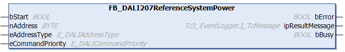

FB_DALI207ReferenceSystemPower
The DALI control gear measures and stores the performance level of the system, in order to detect load increase and decrease.
![]() | Prior to the DALI command REFERENCE SYSTEM POWER, the function block sends the DALI command ENABLE DEVICE TYPE 6, as is necessary for application extended commands (see also FB_DALI102EnableDeviceType). |
![]() | The function block sends the DALI command REFERENCE SYSTEM POWER twice, as foreseen by the DALI standard for certain DALI commands. |
Inputs
bStart : BOOL;
nAddress : BYTE;
Outputs
bError : BOOL;
bBusy : BOOL;
bBusy | BOOL | The output is set as soon as execution of the DALI commands has commenced. It remains active until all DALI commands have been processed. For some errors (e.g. faulty parameters), bError is set immediately after the positive edge at bStart without bBusy switching to TRUE. |
