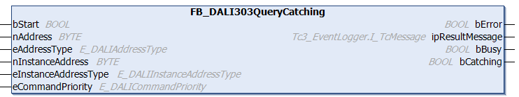

FB_DALI303QueryCatching
FB_DALI303QueryCatching 1:
The function block queries whether Catching is active.
The Catching can be enabled by FB_DALI303CatchMovement.
The output bCatching contains a valid value only if the function block was executed without errors (bError = FALSE).
FB_DALI303QueryCatching 2:
FB_DALI303QueryCatching 3: Inputs
  bStart               : BOOL;
  nAddress             : BYTE;
  eAddressType         : E_DALIAddressType := E_DALIAddressType.Short;
  nInstanceAddress     : BYTE := 0;
  eInstanceAddressType : E_DALIInstanceAddressType := E_DALIInstanceAddressType.InstanceNumber;
  eCommandPriority     : E_DALICommandPriority := E_DALICommandPriority.MiddleLow;

FB_DALI303QueryCatching 4:
The command priorities are supported by the KL6821 from the firmware version BD.
FB_DALI303QueryCatching 5: Outputs
  bCatching               : BOOL;
Type
ipResultMessage
I_TcMessage
bBusy
bCatching
Catching is active.
