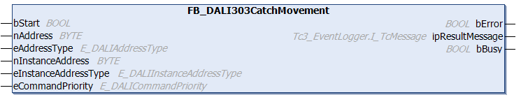

FB_DALI303CatchMovement
Catching is activated for the DALI control devices by this function block. If the DALI control device detects motion, an event is sent once and the Catching is reset.
The Event Filter should be set so that the Movement event is disabled. This ensures that the event is only sent once as soon as Catching is active and movement is detected.
![]() | The function block cannot be used when using the KL6811. |
Inputs
bStart : BOOL;
nAddress : BYTE;
nInstanceAddress : BYTE := 0;
eInstanceAddressType : E_DALIInstanceAddressType := E_DALIInstanceAddressType.InstanceNumber;
eAddressType | Defines whether the input nAddress contains a short address (0…63) or a group address (0…31). The input nAddress has no meaning if a broadcast or a broadcast to unaddressed devices (BroadcastUnaddr) has been selected. | |
nInstanceAddress | BYTE | Instance number within a DALI control device. A DALI control device can support multiple instance numbers. |
eInstanceAddressType | Defines the access mode to the desired instance within the DALI control device. | |
![]() | The command priorities are supported by the KL6821 from the firmware version BD. |
Outputs
bError : BOOL;
bBusy : BOOL;
bBusy | BOOL | The output is set as soon as execution of the DALI commands has commenced. It remains active until all DALI commands have been processed. |
Properties
ipDALICommunication | I_DALICommunication | Get,Set | 0 | Interface Pointer to the communication block (see Transfer of the reference to the communication block). |
Requirements
Development environment | required PLC library |
TwinCAT from v3.1.4022.29 | Tc3_DALI from v3.1.4.0 |
