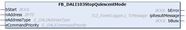

FB_DALI103StopQuiescentMode
FB_DALI103StopQuiescentMode 1:
The function block interrupts the Quiescent mode prematurely.
Quiescent mode can be started with the function block FB_DALI103StartQuiescentMode.
FB_DALI103StopQuiescentMode 2:
The function block sends the DALI command STOP QUIESCENT MODE twice, as required by the DALI standard for certain DALI commands.
FB_DALI103StopQuiescentMode 3:
FB_DALI103StopQuiescentMode 4: Inputs
  bStart            : BOOL;
  nAddress          : BYTE;
Type
bStart
nAddress
BYTE
Address of a DALI control device or a DALI group.
eAddressType
E_DALIAddressType
Defines whether the input nAddress contains a short address (0…63) or a group address (0…31). The input nAddress has no meaning if a broadcast or a broadcast to unaddressed devices (BroadcastUnaddr) has been selected.
eCommandPriority
E_DALICommandPriority
FB_DALI103StopQuiescentMode 5:
The command priorities are supported by the KL6821 from the firmware version BD.
FB_DALI103StopQuiescentMode 6: Outputs
Type
ipResultMessage
I_TcMessage
bBusy
FB_DALI103StopQuiescentMode 7: Properties
Type
Access
Initial value
ipDALICommunication
I_DALICommunication
Get, Set
NULL
