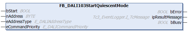

FB_DALI103StartQuiescentMode 1:
The function block enables the Quiescent Mode for approx. 15 minutes.
In Quiescent mode, no commands and events are sent from the DALI control device.
Quiescent mode can be terminated prematurely with the function block FB_DALI103StopQuiescentMode.

FB_DALI103StartQuiescentMode 4: Inputs
  bStart            : BOOL;
  nAddress          : BYTE;
Type
bStart
nAddress
BYTE
Address of a DALI control device or a DALI group.
eAddressType
E_DALIAddressType
Defines whether the input nAddress contains a short address (0…63) or a group address (0…31). The input nAddress has no meaning if a broadcast or a broadcast to unaddressed devices (BroadcastUnaddr) has been selected.
eCommandPriority
E_DALICommandPriority
FB_DALI103StartQuiescentMode 5:
The command priorities are supported by the KL6821 from the firmware version BD.
