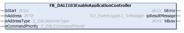

FB_DALI103EnableApplicationController 4: Inputs
  bStart            : BOOL;
  nAddress          : BYTE;
Type
bStart
nAddress
BYTE
Address of a DALI control device or a DALI group.
eAddressType
E_DALIAddressType
Defines whether the input nAddress contains a short address (0…63) or a group address (0…31). The input nAddress has no meaning if a broadcast or a broadcast to unaddressed devices (BroadcastUnaddr) has been selected.

FB_DALI103EnableApplicationController 5:
The command priorities are supported by the KL6821 from the firmware version BD.
FB_DALI103EnableApplicationController 6: Outputs
Type
ipResultMessage
I_TcMessage
bBusy
