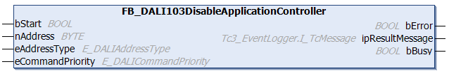

The function block deactivates the application controller (see applicationActive).
The application controller can be activated with the function block FB_DALI103EnableApplicationController.
FB_DALI103DisableApplicationController 2:
The function block sends the DALI command DISABLE APPLICATION CONTROLLER twice, as required by the DALI standard for certain DALI commands.
FB_DALI103DisableApplicationController 3:
FB_DALI103DisableApplicationController 4: Inputs
  bStart            : BOOL;
  nAddress          : BYTE;
Type
bStart
nAddress
BYTE
Address of a DALI control device or a DALI group.
eAddressType
E_DALIAddressType
eCommandPriority
E_DALICommandPriority
FB_DALI103DisableApplicationController 5:
FB_DALI103DisableApplicationController 6: Outputs
Type
ipResultMessage
I_TcMessage
bBusy
FB_DALI103DisableApplicationController 7: Properties
Type
Access
Initial value
ipDALICommunication
I_DALICommunication
Get, Set
NULL
Requirements
Development environment
required PLC library
TwinCAT from v3.1.4022.29
Tc3_DALI from v3.1.4.0
