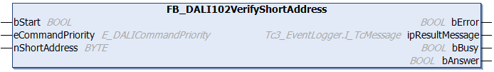

FB_DALI102VerifyShortAddress
The function block checks whether the variable shortAddress matches the value nShortAddress for all selected DALI control gears.
DALI control gears are selected if the randomAddress of the DALI control gear is the same as the searchAddress and the DALI command INITIALIZE (see FB_DALI102Initialise) was executed previously.
This function block is required if addressing of the DALI control gears is to be implemented in the PLC. The function block FB_DALI102Addressing can be used to assign the addresses from the PLC.
The output bAnswer only contains a valid value if the function block was executed without errors (bError = FALSE).
Inputs
bStart : BOOL;
nShortAddress : BYTE;
eCommandPriority | E_DALICommandPriority | Priority (low, middle low, middle, middle high, high) with which the DALI commands are sent (see E_DALICommandPriority). |
Name | Type | Description |
nShortAddress | BYTE | Short address with which the own short address is compared |
Outputs
bError : BOOL;
bBusy : BOOL;
bAnswer : BOOL;
bBusy | BOOL | The output is set as soon as execution of the DALI commands has commenced. It remains active until all DALI commands have been processed. For some errors (e.g. faulty parameters), bError is set immediately after the positive edge at bStart without bBusy switching to TRUE. |
bAnswer | BOOL | Is TRUE if nShortAddress is equal to its own short address. |
Properties
ipDALICommunication | I_DALICommunication | Get, Set | NULL | Interface Pointer to the communication block (see Transfer of the reference to the communication block). |
