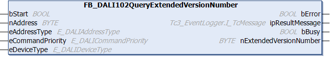

FB_DALI102QueryExtendedVersionNumber
FB_DALI102QueryExtendedVersionNumber 1:
The function block reads the version number for the implemented, application extended commands from the DALI control gear.
This command belongs to the application extended commands.
FB_DALI102QueryExtendedVersionNumber 2:
Since each DALI control gear can support several device types, the DALI command ENABLE DEVICE TYPE must be called before each application-related extension command.
Application extended commands are defined in the IEC 62386-2xx standard.
The function block FB_DALI102QueryExtendedVersionNumber independently executes the DALI command ENABLE DEVICE TYPE internally.
The input variable eDeviceType specifies for which device type the version number is to be read out.
The output nExtendedVersionNumber contains a valid value only if the function block was executed without errors (bError = FALSE).
FB_DALI102QueryExtendedVersionNumber 3: Inputs
  bStart            : BOOL;
  nAddress          : BYTE;
  eDeviceType       : E_DALIDeviceType;
Type
bStart
nAddress
BYTE
eAddressType
E_DALIAddressType
eCommandPriority
E_DALICommandPriority
FB_DALI102QueryExtendedVersionNumber 4:
Type
eDeviceType
E_DALIDeviceType
Identification of the device type (see E_DALIDeviceType).
FB_DALI102QueryExtendedVersionNumber 5: Outputs
  nExtendedVersionNumber  : BYTE;
Type
ipResultMessage
I_TcMessage
bBusy
BYTE
Version number of the selected device type within the DALI control gear.
