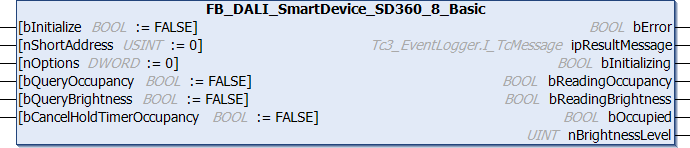

The function block represents the SD360-8 Basic DALI sensor from SMART DEVICE.
This outputs an occupancy signal (instance 0) and a brightness value (instance 1).
For information on the exact functions of the individual instances, please refer to the manufacturer's device documentation.

The existing parameters can be overwritten by changing the properties listed below. All parameters are written to the DALI control device by a positive edge at bInitialize and stored there.
The outputs with the output values of the DALI device only contain valid values if the function block was executed without errors (bError = FALSE). If the output bError = TRUE, the outputs with the output values must not be evaluated.
The reading can be triggered immediately via the input variables bQueryOccupancy and bQueryBrightness, even if the corresponding instance is not enabled.

Inputs
bInitialize : BOOL := FALSE;
nShortAddress : BYTE := 0;
nOptions : DWORD := 0;
bQueryOccupancy : BOOL := FALSE;
bQueryBrightness : BOOL := FALSE;
bCancelHoldTimerOccupancy : BOOL := FALSE;
bInitialize | BOOL | The configuration of the DALI control device is started by a positive edge at this input. During this time no DALI commands are processed. |
nShortAddress | BYTE | Short address (0…63) of the DALI control device. |
nOptions | DWORD | Reserved for future extensions. |
bQueryOccupancy | BOOL | The occupancy is queried immediately by a positive edge at this input. |
bQueryBrightness | BOOL | The brightness is queried immediately by a positive edge at this input. |
bCancelHoldTimerOccupancy | BOOL | A positive edge at this input prematurely ends the Hold Timer and resets the output bOccupied. |
Outputs
bError : BOOL;
bInitializing : BOOL;
bReadingOccupancy : BOOL;
bReadingBrightness : BOOL;
bOccupied : BOOL;
nBrightnessLevel : UINT;
bError | BOOL | This output is switched to TRUE if an error occurs during the execution. Further information about the error can be queried via the variable ipResultMessage. |
ipResultMessage | I_TcMessage | Interface pointer (see error evaluation) that can be used to obtain detailed information about the processing of the function block (see runtime messages). |
bInitializing | BOOL | The output is set as soon as the initialization of the DALI control device has been started, and remains active until all DALI commands have been executed. |
bReadingOccupancy | BOOL | The output is TRUE as long as values of the instance of the movement sensor are being read by the DALI control device. |
bReadingBrightness | BOOL | The output is TRUE as long as values of the instance of the light sensor are being read by the DALI control device. |
bOccupied | BOOL | If the output is TRUE, then occupancy has been detected in the detection range of the occupancy sensor. |
nBrightnessLevel | UINT | Measured brightness value of the light sensor. |
