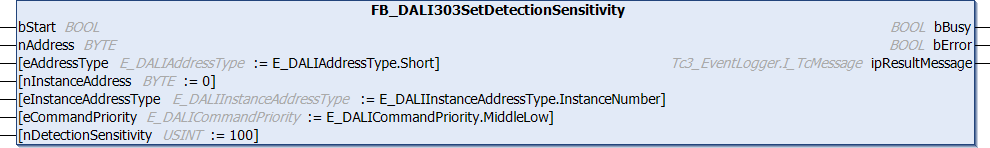

FB_DALI303SetDetectionSensitivity 5: Inputs
  bStart               : BOOL;
  nAddress             : BYTE;
  eAddressType         : E_DALIAddressType := E_DALIAddressType.Short;
  nInstanceAddress     : BYTE := 0;
  eInstanceAddressType : E_DALIInstanceAddressType := E_DALIInstanceAddressType.InstanceNumber;
  eCommandPriority     : E_DALICommandPriority := E_DALICommandPriority.MiddleLow;
  nDetectionSensitivity: USINT := 100;
