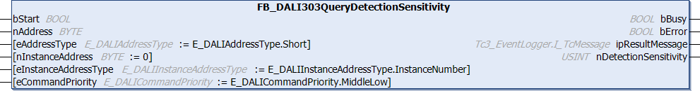

FB_DALI303QueryDetectionSensitivity 1:
The function block reads the detectionSensitivity variable.
The value is read in steps of 1 %. The permissible value range is 0 % to 100 %.
This variable is optional and is not provided by all DALI control devices that support Part 303. In this case, no value is returned. If the value 255 is read out, the sensitivity setting is not supported.
The output nDetectionSensitivity contains a valid value only if the function block was executed without errors (bError = FALSE).

FB_DALI303QueryDetectionSensitivity 3: Inputs
  bStart               : BOOL;
  nAddress             : BYTE;
  eAddressType         : E_DALIAddressType := E_DALIAddressType.Short;
  nInstanceAddress     : BYTE := 0;
  eInstanceAddressType : E_DALIInstanceAddressType := E_DALIInstanceAddressType.InstanceNumber;
  eCommandPriority     : E_DALICommandPriority := E_DALICommandPriority.MiddleLow;

FB_DALI303QueryDetectionSensitivity 4:
The command priorities are supported by the KL6821 from the firmware version BD.
FB_DALI303QueryDetectionSensitivity 5: Outputs
  nDetectionSensibility   : USINT;
Type
ipResultMessage
I_TcMessage
bBusy
USINT
Value of the detectionSensitivity variable [1 %]. The output value is between 0 and 100, as a multiple of the step size of 1 %. If the value 255 is read out, the sensitivity setting is not supported.
