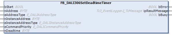

FB_DALI306SetDeadtimeTimer
FB_DALI306SetDeadtimeTimer 1:
The function block stores the value of nDeadtime in the variable tDeadtime of the DALI control device.
The value is written in steps of 50 ms. The permissible value range is from 0 s to 12.75 s. It is entered in numbers from 0 to 255.
FB_DALI306SetDeadtimeTimer 2:
The function block changes the DTR0 of all connected DALI control devices.
FB_DALI306SetDeadtimeTimer 3:
The function block sends the DALI command SET DEADTIME TIMER twice, as required by the DALI standard for certain DALI commands.
FB_DALI306SetDeadtimeTimer 4:
FB_DALI306SetDeadtimeTimer 5: Inputs
  bStart               : BOOL;
  nAddress             : BYTE;
  eAddressType         : E_DALIAddressType := E_DALIAddressType.Short;
  nInstanceAddress     : BYTE := 0;
  eInstanceAddressType : E_DALIInstanceAddressType := E_DALIInstanceAddressType.InstanceNumber;
  eCommandPriority     : E_DALICommandPriority := E_DALICommandPriority.MiddleLow;
  nDeadtime            : BYTE := 30;
