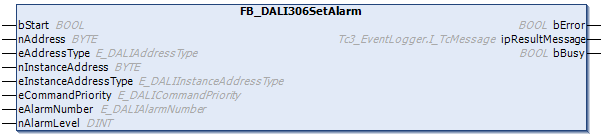

FB_DALI306SetAlarm
FB_DALI306SetAlarm 1:
The function block saves the value nAlarmLevel in the DALI control device. The input eAlarmNumber specifies for which alarm (Alarm 0 ... Alarm 3) the alarm level is to be saved.
FB_DALI306SetAlarm 2:
The function block changes the DTR0, DTR1 and DTR2 of all connected DALI control devices.
FB_DALI306SetAlarm 3:
The function block sends the DALI command SET ALARM twice, as required by the DALI standard for certain DALI commands.
FB_DALI306SetAlarm 4:
FB_DALI306SetAlarm 5: Inputs
  bStart               : BOOL;
  nAddress             : BYTE;
  eAddressType         : E_DALIAddressType := E_DALIAddressType.Short;
  nInstanceAddress     : BYTE := 0;
  eInstanceAddressType : E_DALIInstanceAddressType := E_DALIInstanceAddressType.InstanceNumber;
  eCommandPriority     : E_DALICommandPriority := E_DALICommandPriority.MiddleLow;
  eAlarmNumber         : E_DALIAlarmNumber;
  nAlarmLevel          : DINT := 16#3F_FF_FF;
