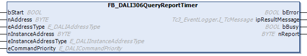

FB_DALI306QueryReportTimer
FB_DALI306QueryReportTimer 1:
The function block reads the variable tReport.
The value is read in steps of 5 s. The permissible value range is from 0 s to 21 min 15 s. It is output in numbers from 0 to 255.
FB_DALI306QueryReportTimer 2:
The output nReport contains a valid value only if the function block was executed without errors (bError = FALSE).
FB_DALI306QueryReportTimer 3: Inputs
  bStart               : BOOL;
  nAddress             : BYTE;
  eAddressType         : E_DALIAddressType := E_DALIAddressType.Short;
  nInstanceAddress     : BYTE := 0;
  eInstanceAddressType : E_DALIInstanceAddressType := E_DALIInstanceAddressType.InstanceNumber;
  eCommandPriority     : E_DALICommandPriority := E_DALICommandPriority.MiddleLow;
Type
bStart
nAddress
BYTE
Address of a DALI control device or a DALI group.
eAddressType
E_DALIAddressType
Defines whether the input nAddress contains a short address (0…63) or a group address (0…31). The input nAddress has no meaning if a broadcast or a broadcast to unaddressed devices (BroadcastUnaddr) has been selected.
nInstanceAddress
BYTE
Instance number within a DALI control device. A DALI control device can support multiple instance numbers.
Defines the access mode to the desired instance within the DALI control device.
eCommandPriority
FB_DALI306QueryReportTimer 4:
The command priorities are supported by the KL6821 from the firmware version BD.
FB_DALI306QueryReportTimer 5: Outputs
  nReport                 : USINT;
Type
ipResultMessage
I_TcMessage
bBusy
nReport
USINT
Value of the variable tReport [5 s]. The output value is between 0 and 255, as a multiple of the step size of 5 s.
