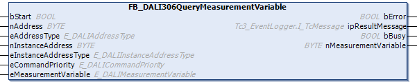

The function block reads a measured value defined by the eMeasurementVariable parameter from the DALI control device and outputs the value at the output nMeasurementVariable.
FB_DALI306QueryMeasurementVariable 2:
The function block changes the DTR0 of all connected DALI control devices.
FB_DALI306QueryMeasurementVariable 3:
The output nMeasurementVariable only contains a valid value if the function block was executed without errors (bError = FALSE).
FB_DALI306QueryMeasurementVariable 4: Inputs
  bStart                  : BOOL;
  nAddress                : BYTE;
  eAddressType            : E_DALIAddressType := E_DALIAddressType.Short;
  nInstanceAddress        : BYTE := 0;
  eInstanceAddressType    : E_DALIInstanceAddressType := E_DALIInstanceAddressType.InstanceNumber;
  eCommandPriority        : E_DALICommandPriority := E_DALICommandPriority.MiddleLow;
  eMeasurementVariable    : E_DALIMeasurementVariable;
Type
bStart
nAddress
BYTE
eAddressType
E_DALIAddressType
Defines whether the input nAddress contains a short address (0…63) or a group address (0…31). The input nAddress has no meaning if a broadcast or a broadcast to unaddressed devices (BroadcastUnaddr) has been selected.
nInstanceAddress
BYTE
Instance number within a DALI control device. A DALI control device can support multiple instance numbers.
Defines the access mode to the desired instance within the DALI control device.
eCommandPriority
FB_DALI306QueryMeasurementVariable 5:
The command priorities are supported by the KL6821 from the firmware version BD.
Type
Variable to be read from the DALI control device.
FB_DALI306QueryMeasurementVariable 6: Outputs
  nMeasurementVariable    : BYTE;
Type
ipResultMessage
I_TcMessage
bBusy
BYTE
Contains the value of the read variable.
