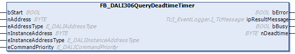

The function block reads the variable tDeadtime.
The value is read in steps of 50 ms. The permissible value range is from 0 s to 12.75 s. It is output in numbers from 0 to 255.
![]() | The function block cannot be used when using the KL6811. |
The output nDeadtime contains a valid value only if the function block was executed without errors (bError = FALSE).
Inputs
bStart : BOOL;
nAddress : BYTE;
nInstanceAddress : BYTE := 0;
eInstanceAddressType : E_DALIInstanceAddressType := E_DALIInstanceAddressType.InstanceNumber;
nAddress | BYTE | Address of a DALI control device or a DALI group. |
eAddressType | Defines whether the input nAddress contains a short address (0…63) or a group address (0…31). The input nAddress has no meaning if a broadcast or a broadcast to unaddressed devices (BroadcastUnaddr) has been selected. | |
nInstanceAddress | BYTE | Instance number within a DALI control device. A DALI control device can support multiple instance numbers. |
eInstanceAddressType | Defines the access mode to the desired instance within the DALI control device. | |
![]() | The command priorities are supported by the KL6821 from the firmware version BD. |
Outputs
bError : BOOL;
bBusy : BOOL;
nDeadtime : BYTE;
bBusy | BOOL | The output is set as soon as execution of the DALI commands has commenced. It remains active until all DALI commands have been processed. For some errors (e.g. faulty parameters), bError is set immediately after the positive edge at bStart without bBusy switching to TRUE. |
nDeadtime | BYTE | Value of the variable tDeadtime [50 ms]. The output value is between 0 and 255, as a multiple of the step size of 50 ms. |
