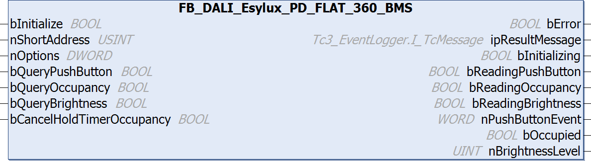

FB_DALI_Esylux_PD_FLAT_360_BMS 1:
The function block FB_DALI_Esylux_PD_FLAT_360_BMS represents the DALI sensors PD-FLAT 360/8 RW BMS DALI-2, PD-FLAT 360/8 SW BMS DALI-2 and PD-FLAT-L 360/8 RW BMS DALI-2 from Esylux.
This outputs a push button signal (instance 0), an occupancy signal (instance 1) and the measured brightness value (instance 2).
For information on the exact functions of the individual instances, please refer to the manufacturer's device documentation.
Further information on the supported instance types can be found here:
Part 301 (push buttons) – Introduction
Part 303 (occupancy sensors) – Introduction
Part 304 (light sensors) – Introduction
The existing parameters can be overwritten by changing the properties listed below. All parameters are written to the DALI control device by a positive edge at bInitialize and stored there.
The outputs with the output values of the DALI device only contain valid values if the function block was executed without errors (bError = FALSE). If the output bError = TRUE, the outputs with the output values must not be evaluated.
The reading can be triggered immediately via the input variables bQueryPushButton, bQueryOccupancy and bQueryBrightness, even if the corresponding instance is not enabled.

FB_DALI_Esylux_PD_FLAT_360_BMS 4: Inputs
  bInitialize                : BOOL  := FALSE;
  nShortAddress              : USINT := 0;
  nOptions                   : DWORD := 0;
  bQueryPushButton           : BOOL  := FALSE;
  bQueryOccupancy            : BOOL  := FALSE;
  bQueryBrightness           : BOOL  := FALSE;
  bCancelHoldTimerOccupancy  : BOOL  := FALSE;

FB_DALI_Esylux_PD_FLAT_360_BMS 5: Outputs
  bError                     : BOOL;
  ipResultMessage            : I_TcMessage;
  bInitializing              : BOOL;
  bReadingPushButton         : BOOL;
  bReadingOccupancy          : BOOL;
  bReadingBrightness         : BOOL;
  nPushButtonEvent           : WORD;
  bOccupied                  : BOOL;
  nBrightnessLevel           : UINT;
