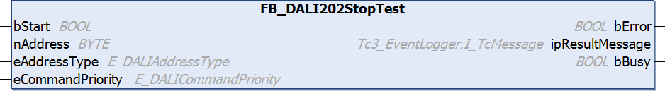

FB_DALI202StopTest
FB_DALI202StopTest 1:
The function block stops a function or duration test.
Since all tests are stopped by the function block, bit 4 and bit 5 are also reset in the variable emergencyStatus.
FB_DALI202StopTest 2:
Prior to the DALI command STOP TEST, the function block sends the DALI command ENABLE DEVICE TYPE 1, as is necessary for application extended commands (see also FB_DALI102EnableDeviceType).
FB_DALI202StopTest 3:
The function block sends the DALI command STOP TEST twice, as required by the DALI standard for certain DALI commands.
FB_DALI202StopTest 4: Inputs
  bStart            : BOOL;
  nAddress          : BYTE;
Type
bStart
nAddress
BYTE
eAddressType
E_DALIAddressType
eCommandPriority
E_DALICommandPriority
FB_DALI202StopTest 5:
FB_DALI202StopTest 6: Outputs
Type
ipResultMessage
I_TcMessage
bBusy
FB_DALI202StopTest 7: Properties
Type
Access
Initial value
ipDALICommunication
I_DALICommunication
Get,Set
0
Requirements
Development environment
Required PLC library
TwinCAT from v3.1.4024.35
Tc3_DALI from v3.13.0.0
