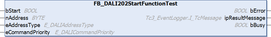

FB_DALI202StartFunctionTest 4: Inputs
  bStart            : BOOL;
  nAddress          : BYTE;
Type
bStart
nAddress
BYTE
eAddressType
E_DALIAddressType
eCommandPriority
E_DALICommandPriority
FB_DALI202StartFunctionTest 5:
FB_DALI202StartFunctionTest 6: Outputs
Type
ipResultMessage
I_TcMessage
bBusy
