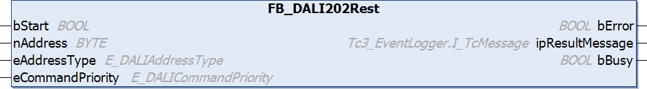

FB_DALI202Rest
FB_DALI202Rest 1:
This function block is used to switch off the lamp when the DALI control gear is in emergency mode.
Otherwise the system switches to normal operation if mains voltage is available again, or if the function block FB_DALI202ReLightResetInhibit was called.
FB_DALI202Rest 2:
Prior to the DALI command REST, the function block sends the DALI command ENABLE DEVICE TYPE 1, as is necessary for application extended commands (see also FB_DALI102EnableDeviceType).
FB_DALI202Rest 3:
The function block sends the DALI command REST twice, as required by the DALI standard for certain DALI commands.
FB_DALI202Rest 4: Inputs
  bStart            : BOOL;
  nAddress          : BYTE;
Type
bStart
nAddress
BYTE
eAddressType
E_DALIAddressType
eCommandPriority
E_DALICommandPriority
FB_DALI202Rest 5:
FB_DALI202Rest 6: Outputs
Type
ipResultMessage
I_TcMessage
bBusy
FB_DALI202Rest 7: Properties
Type
Access
Initial value
ipDALICommunication
I_DALICommunication
Get,Set
0
Requirements
Development environment
Required PLC library
TwinCAT from v3.1.4024.35
Tc3_DALI from v3.13.0.0
