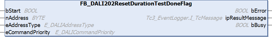

FB_DALI202ResetDurationTestDoneFlag
FB_DALI202ResetDurationTestDoneFlag 1:
This function block resets bit 2 of the variable emergencyStatus.
FB_DALI202ResetDurationTestDoneFlag 2:
Prior to the DALI command RESET DURATION TEST DONE FLAG, the function block sends the DALI command ENABLE DEVICE TYPE 1, as is necessary for application extended commands (see also FB_DALI102EnableDeviceType).
FB_DALI202ResetDurationTestDoneFlag 3:
The function block sends the DALI command RESET DURATION TEST DONE FLAG twice, as required by the DALI standard for certain DALI commands.
FB_DALI202ResetDurationTestDoneFlag 4: Inputs
  bStart            : BOOL;
  nAddress          : BYTE;
Type
bStart
nAddress
BYTE
eAddressType
E_DALIAddressType
eCommandPriority
E_DALICommandPriority
FB_DALI202ResetDurationTestDoneFlag 5:
FB_DALI202ResetDurationTestDoneFlag 6: Outputs
Type
ipResultMessage
I_TcMessage
bBusy
FB_DALI202ResetDurationTestDoneFlag 7: Properties
Type
Access
Initial value
ipDALICommunication
I_DALICommunication
Get, Set
NULL
Requirements
Development environment
Required PLC library
TwinCAT from v3.1.4024.35
Tc3_DALI from v3.13.0.0
